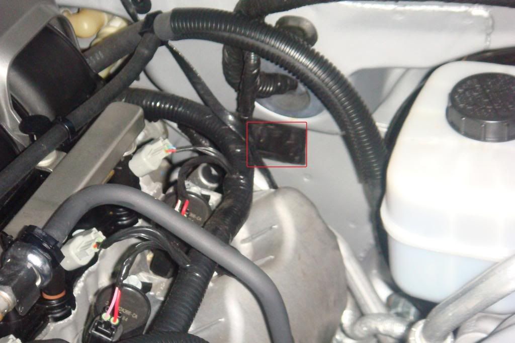

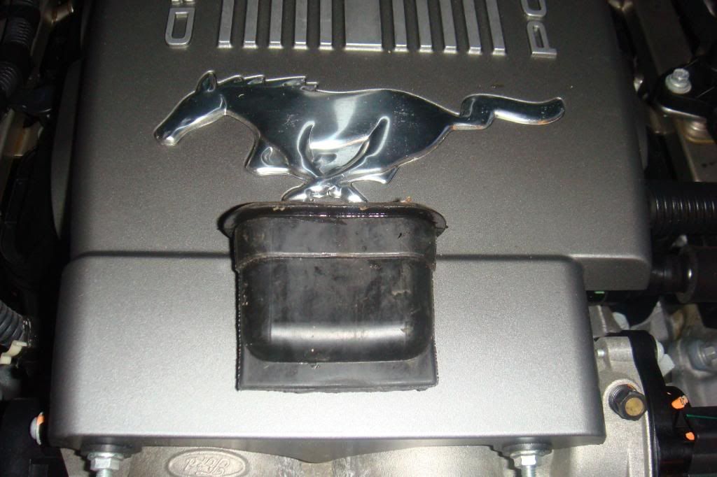

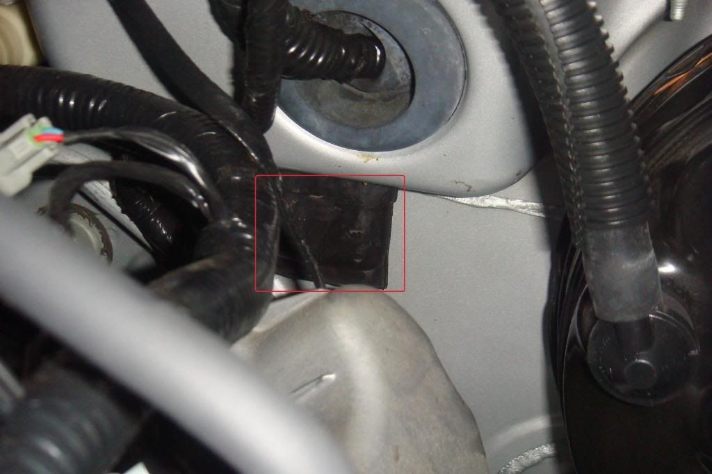

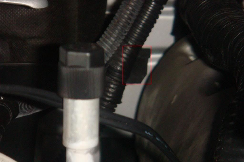

It is a drain catch from the cowl. I noticed it when I was fiddling under the hood and saw some crap sticking out. I pulled it off, very easy, and cleaned it out. Then I ran water down the cowl to flush out the rest of the crap.
There are two, one on each side. See pics for locations.
Drivers side
Passenger side

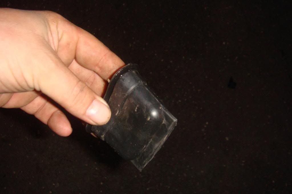

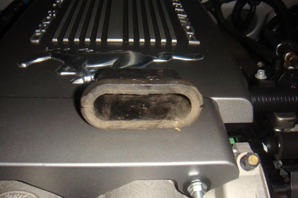

This is what they look like when taken out.
